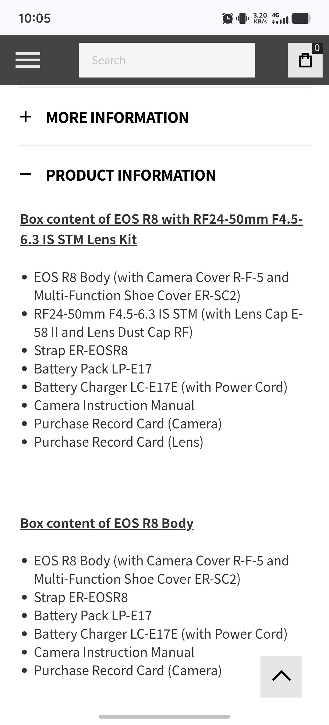

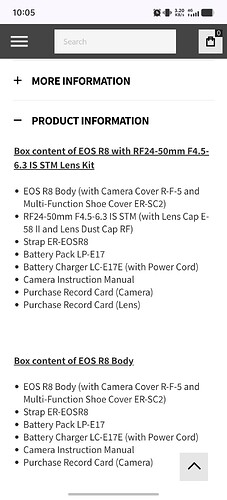

I have attached the specifications of these instruments.
