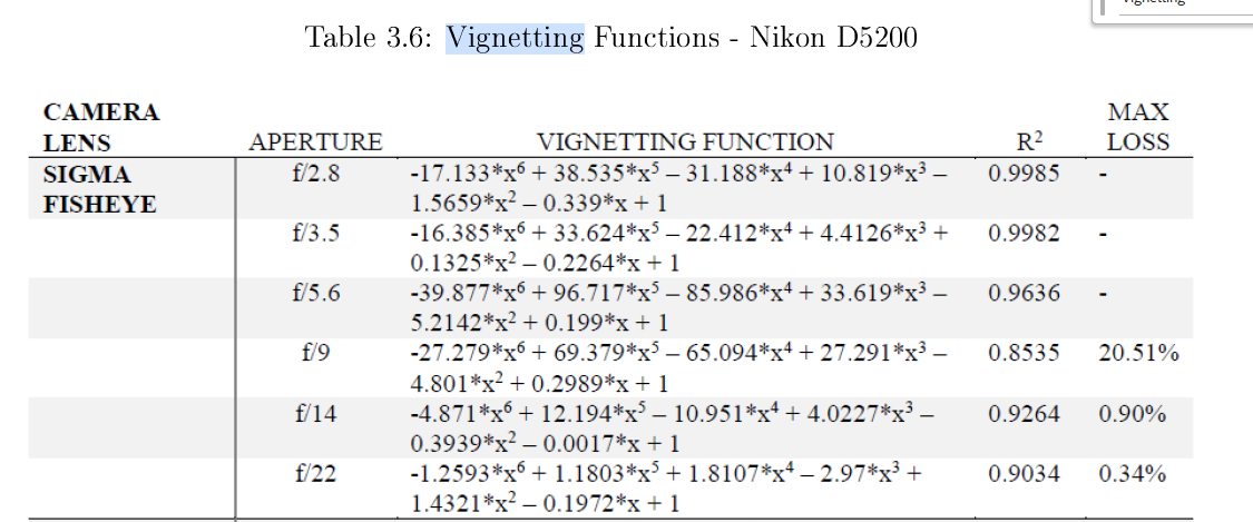

I understand that vignetting correction is important. However, I am not familiar with the vignetting function and do not have the necessary instruments to determine it. Currently, I am using a Nikon Z5 to capture LDR images, which offers a “Vignette Control” feature to help mitigate vignetting effects.
Additionally, a master’s thesis titled “On The Development and Error Analysis of a High Dynamic Range Imaging System for Luminance Measurements” reports that the maximum loss due to vignetting is only 0.9% when using an aperture as small as F/14 (Graduate Thesis Or Dissertation | On the Development and Error Analysis of a High Dynamic Range Imaging System for Luminance Measurements | ID: hd76s042c | CU Scholar).
Given this information, is it acceptable to skip vignetting correction if I use an aperture of F/14 and enable the Vignette Control feature? My primary goal is to evaluate vertical illuminance and DGP.
