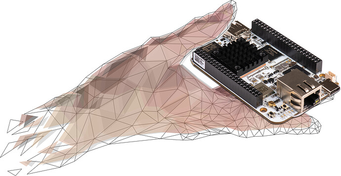

Greg,
Inspired by Mark Stock's semi-recent post, i am curious if HDRgen could be
compiled to work on the Beagle Bone?
BeagleBone is an $89 MSRP, credit-card-sized Linux computer that connects
to the Internet and runs software such as Android 4.0 and Ubuntu. With
plenty of I/O and processing power for real-time analysis provided by an
AM335x 720MHz ARM® processor, BeagleBone can be complemented with cape
plug-in boards to augment functionality.
From a search on the HDRI list archive, i found that:
I managed to compile hdrgen under Lubuntu using VMWare, so if anyone else
wants a copy, let me know. I'll send one to Axel since it's a little more
