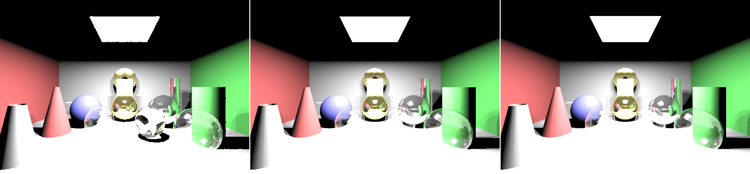

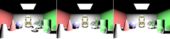

It is coming along slowly. This is a 3 way comparison between rpict from Radiance, my OWL Port rpict and Accelerad rpict.
I need to work on the sampling some more and plan some better test scenes.
Hi @ephb,
Very cool. I can see that the pixel jitter and source sampling are set differently between the three three renders. For validation, it would be useful to see the settings for each render. Are you using irradiance caching? That was the tricky to port to Accelerad because irradiance caching is serial by nature.
Hi @Nathaniel_Jones,
of course you see the issue right away :slight_smile:
I made a mistake somewhere in the pixel sampling code and currently they do not behave the same with the same settings. I will make sure to show settings with the next screenshot.
And this is currently without irradiance caching, as that is not done yet either.

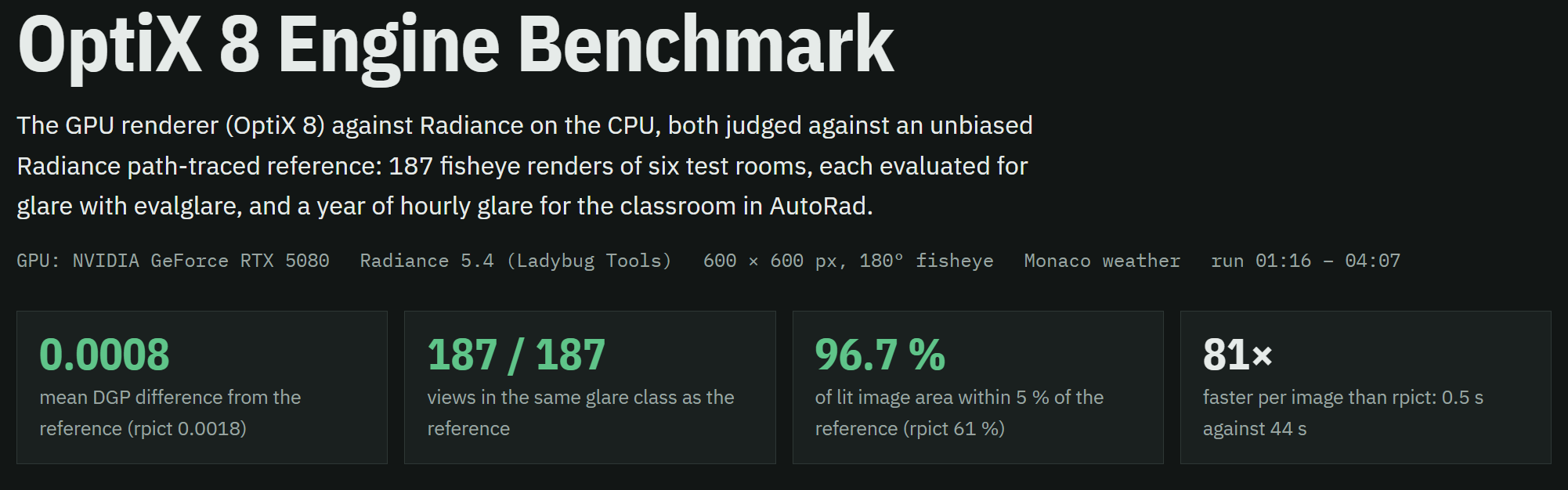

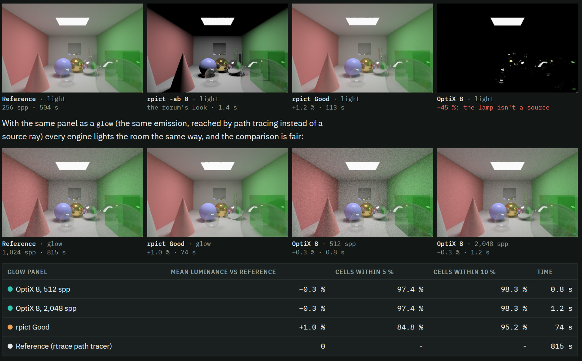

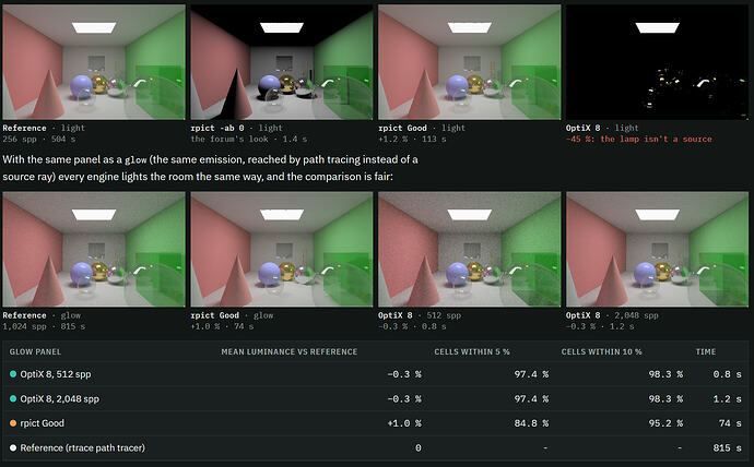

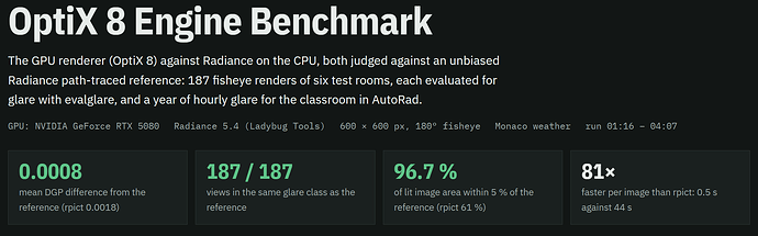

with the help of Claude (I am not going to get the credit for this), I created an Optix8 version that seems to be running fine. I did a few benchmark tests (https://claude.ai/artifact/NoEQFbrsbJJ3LRePZSohiu) and they seem to fall close to unbiased CPU based rpict.
If you can give me a share of settings to stress test it I can figure out whether this is reliable enough or not.
I am using it for personal work only at the moment and not for any benchmarking stuff.

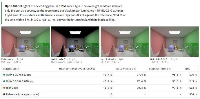

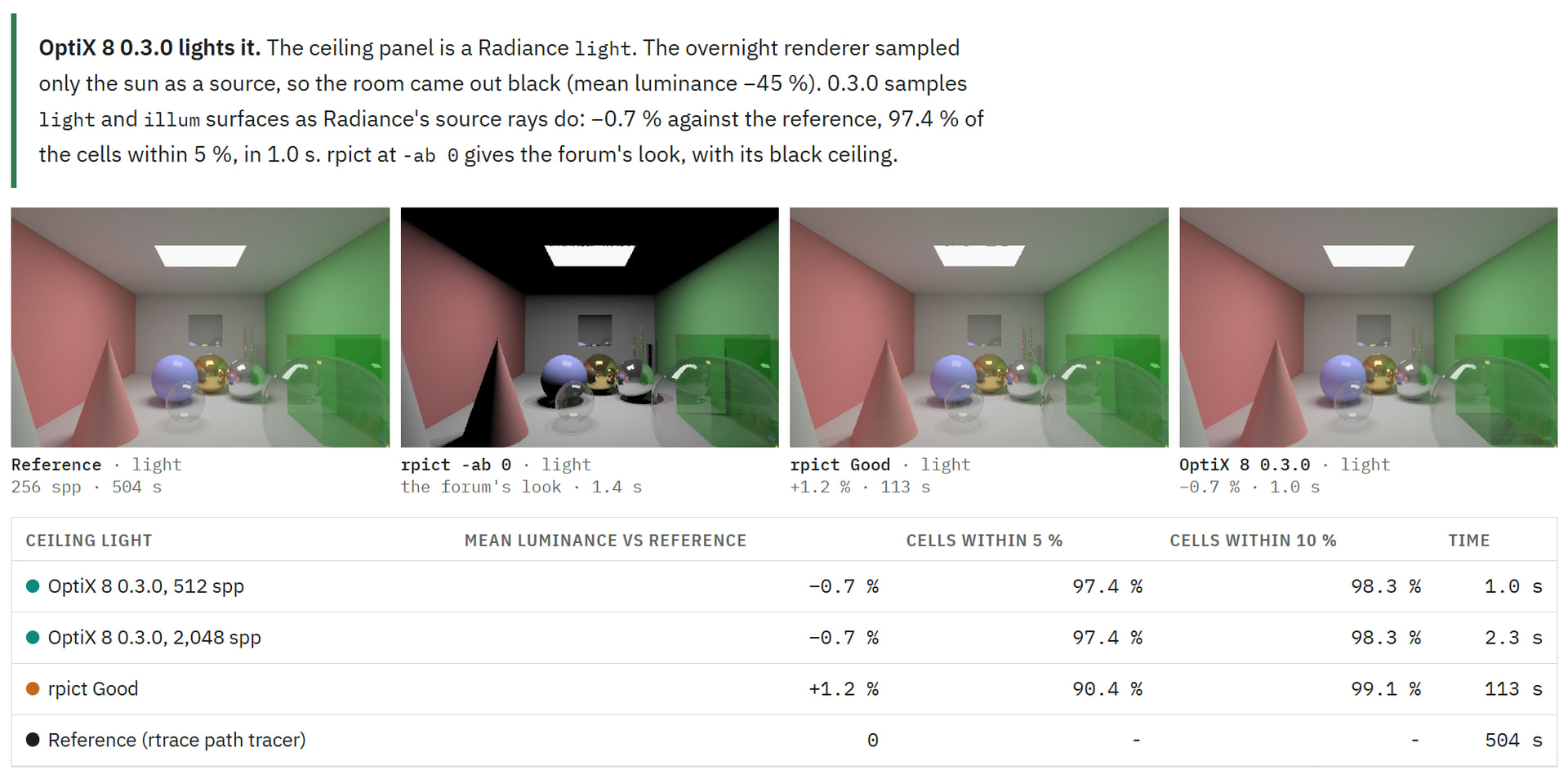

fixed the no lighting error from above
Hi @Byron,
Thanks for sharing your progress. Is this a Claude rewrite of Accelerad, or is it going back to the original Radiance?
Speaking from experience, the hard part of porting Radiance to the GPU is the ambient calculation; the other ray types are fairly straight forward. Thus, to understand the speed of your implementation, we’d want to see how it performs with high numbers of ambient bounces (say -ab 6 -ad 1000 -lr 8 -lw 0.001 for example, and then moving up to -ab 8 -ad 6400 -lr 10 -lw 0.00015). Otherwise, as similar as the pictures might look to each other, they still aren’t matching reality.
Also, rtrace calculations are useful for quantitative comparison of CPU and GPU calculations. Remember that for irradiance calculations using rtrace +I, you need to add one to -ab and -lr for equivalent accuracy.
