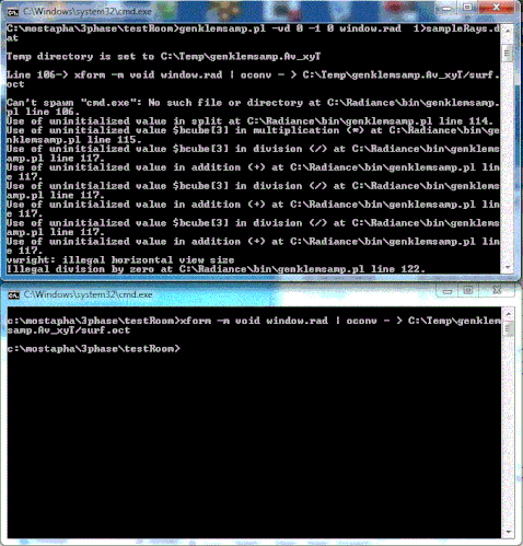

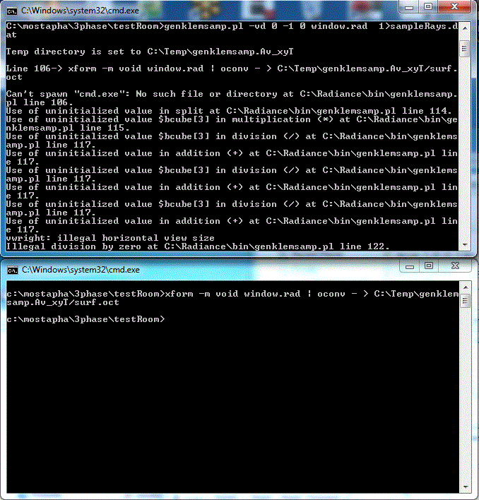

Hi Thomas and Rob,
Thank you Thomas for the reply. Here is the result:
Global symbol "$tmploc" requires explicit package name at C:\Radiance\bin\
genklemsamp.pl line 75.
genklemsamp.pl line 76.
Execution of C:\Radiance\bin\genklemsamp.pl aborted due to compilation
errors.
I tried to solve the proble by adding "my $tmploc;" outside the block but
it then is giving me a similar error to what I had yesterday. I also tried
to change the location to c:\\temp to make sure it is not a permission
issue:
if ($windoz) {
    my $tmploc;
    if (exists $ENV{'TMP'}) {
        my $tmploc = $ENV{'TMP'};
    } else {
        my $tmploc = "C:\\Temp";
    chomp($tmploc);
Here is the error again (line 76 is the last line in the code:
"chomp($tmploc);")
Use of uninitialized value $tmploc in scalar chomp at C:\Radiance\bin\
Use of uninitialized value $tmploc in concatenation (.) or string at
C:\Radiance\bin\genklemsamp.pl line 77.
Can't spawn "cmd.exe": No such file or directory at C:\Radiance\bin\
genklemsamp.pl line 107.
Use of uninitialized value in split at C:\Radiance\bin\genklemsamp.pl line
115.
Use of uninitialized value $bcube[3] in multiplication (*) at
C:\Radiance\bin\genklemsamp.pl line 116.
Use of uninitialized value $bcube[3] in division (/) at C:\Radiance\bin\
genklemsamp.pl line 118.
Use of uninitialized value in addition (+) at
C:\Radiance\bin\genklemsamp.plline 118.
vwright: illegal horizontal view size
Illegal division by zero at C:\Radiance\bin\genklemsamp.pl line 123.

So the problem with the code was $ENV{'TMP'} returns a HASH and Windows
couldn't create the temp folder. I assigned "c:\temp" as the temporary
folder so the code creates the temp folder however it cannot execute the
xform command later.
system "xform -m void @ARGV | oconv - > $td/surf.oct";
I tested it on Windows7 and Windows8 and I assume it is a permission issue
since if I type the same command in the command line, it just works fine
and creates surf.oct in the folder (attached!).
I think if I can find a way to run the commands in an elevated mode from
the Perl script, and modify all (system "do something") lines, then the
script should work just fine in Windows.
Mostapha

Mostapha,
could you try out this version of genklemsamp, please:
http://www.jaloxa.eu/pickup/genklemsamp-aj01.pl
I've made some small changes to the tempdir code.
issue:
if ($windoz) {
     my $tmploc;
     } else {
     chomp($tmploc);
Regards
Axel
Hi Axel,
Thanks for your help.
It does change the folder to Windows temp folder:
C:\Users\usename\AppData\Local\Temp\(randomName) in my case, but it
doesn't create it.
I added one line to create the folder so it does it now but the problem
with executing Xform is still there (system "xform -m void @ARGV | oconv -
$td/surf.oct":wink:
Again, if I write the same command in the command line it works fine.
Best regards,
Mostapha
