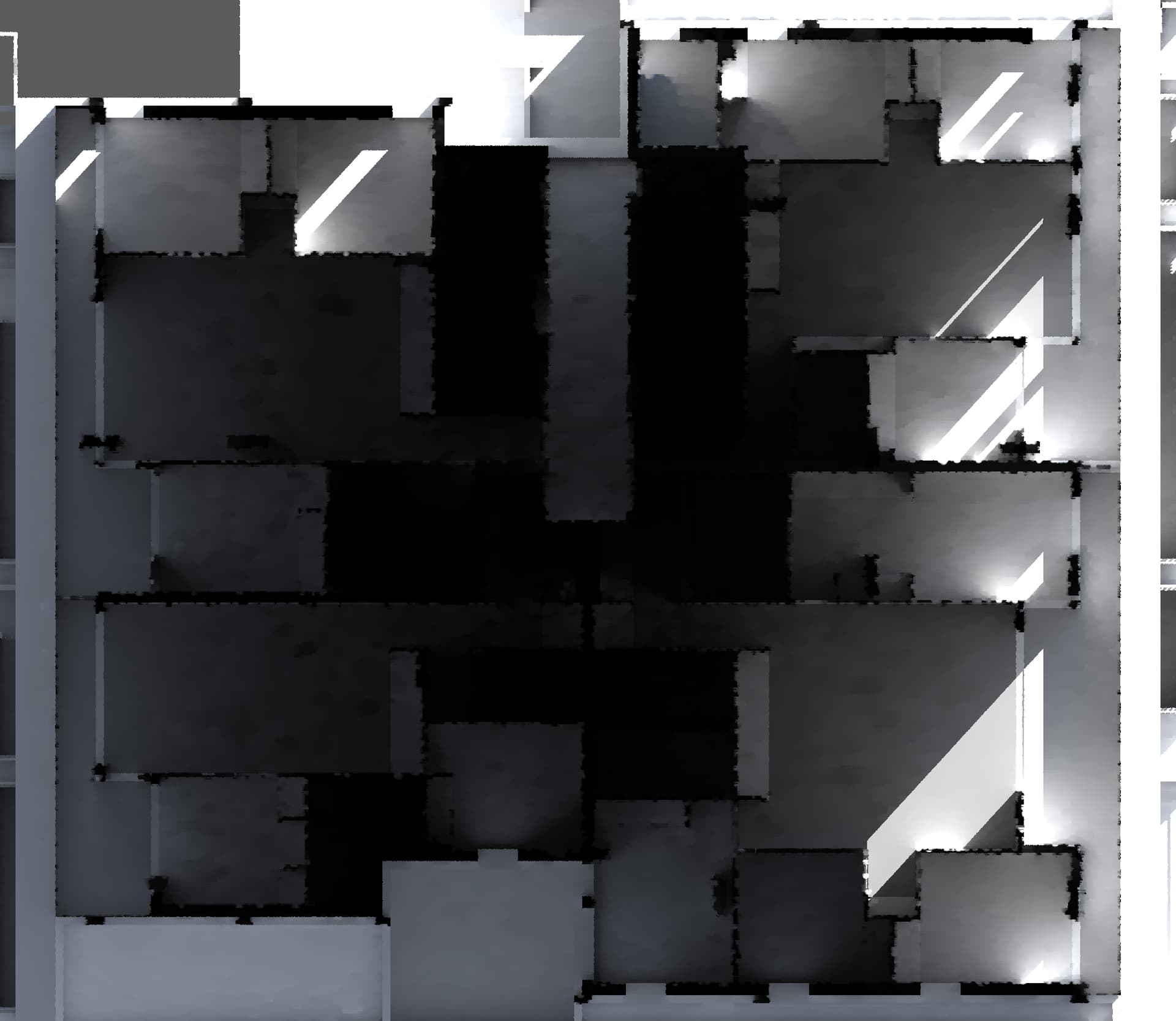

I am attempting to extract the sunlit areas from a .hdr file output from rpict.
The goal is to extract the sunlit pixels in order to combine a sequence of 5 min interval images over the entire day in order to determine the pixels of the space that is sunlit and for how long
these pixels receive sunlight.

If there are multiple solutions to achieving this, i’d be very happy to test anything.

Hi Vince,
If you just want to see the sun patches, set -ab 0 -av 0 0 0 in your calculation, and only the sun patches will be non-zero in the resulting image.
