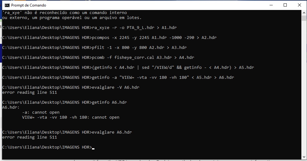

Hello Pierson,
I was actually copying and pasting the command line, but repeating the whole process typing line by line and the error remains.
When I check the information with getinfo the following message appears:
-a: cannot open
VIEW= -vta -vv 180 -vh 180: cannot open
I really can’t understand where I’m going wrong.
It is as if header information is not being entered.
Any suggestions as to what might be going on?

Hi Greg,
Thank you very much for the guidelines. Finally it worked with the rcrop command.
But unfortunately getting -r for some reason is not working. I did everything as you had guided me (following image of the script I used).
I have the latest version of RADIANCE installed on my PC (Radiance 5.4a 2022-07-17 - 1df3bb1a). Even so, getinfo -r and getinfo -a do not work.
The command lines I applied were as follows, in this order:
When I enter the evalglare command, the following appears:
evalglare -V -vta -vh 180 -vv 180 C4_cor.hdr
error reading line 511
When checking the information with getinfo from the C4_cor.hdr image, the following appears:
-r: cannot open
VIEW=: cannot open
I’m using the latest version of Evalglare
evalglare 2.03 release 12.08.2017 by EPFL, J.Wienold
Could you give me some more guidance on what I might be doing wrong?
