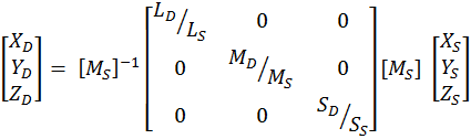

#2.) Perform chromatic adaptation on the computed Trisitimulus values, to account for different white point definitions between source (sensor) & destination (Radiance) illuminants. For this transformation, the Tristimulus of the white point of both the source (S) & the destination (D) illuminants must be defined. Also, the Sharp color space is chosen for the chromatic adaptation transformation (Ref 1.), defined by the matrix, [cid:[email protected]] .
