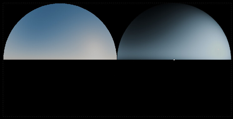

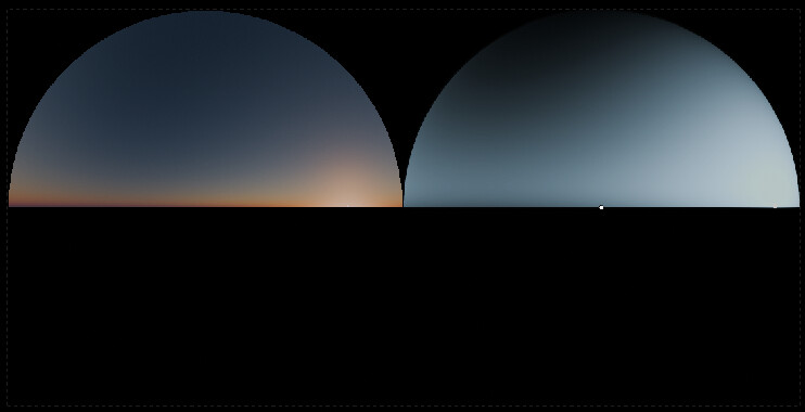

Any suggestions on how to improve on this? Here’s a side by side comparison of Blender (left) and Radiance (right) (note: the fisheye projection probably isn’t identical, but close enough).

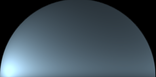

Apart from the obvious colour differences, there also seems to be an “ambient” sky brightness in Blender, whereas if I use -e human the Radiance sky exposure seems to be far too contrasty (strong gradient towards black) to what seems “right”. See top (human) vs bottom (auto):
