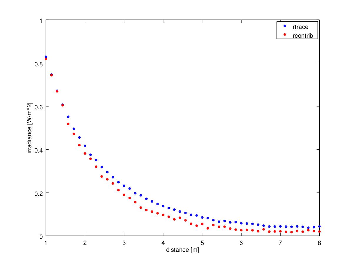

By varying *y* the distance from the "window" in the box I get the
following results.

Hi Mario,
The programs do things very differently from each other.
One source of difference is in the options, both programs require different settings for the same set of options. Rcontrib actually disables the ambient cache by setting -aa 0, so you will need to increase ambient divisions (-ad) parameter along with a few others. As quick experiment you could try 2x or 4x whatever is set for -ad in the rtrace run in your rcontrib run. Also it would be instructive to see what defaults rcontrib uses and perhaps work from those. To do this you can do rcontrib -defaults.

try with -lw a little lower in rtcontrib and also increase rays.
the key is that rtcontrib uses pure monte carlo
rtrace uses ambient interpolation (-aa .1)
G
